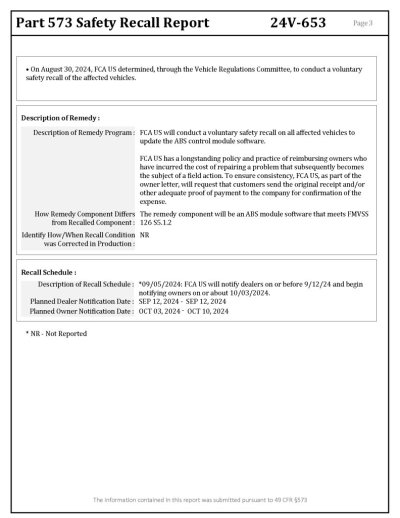

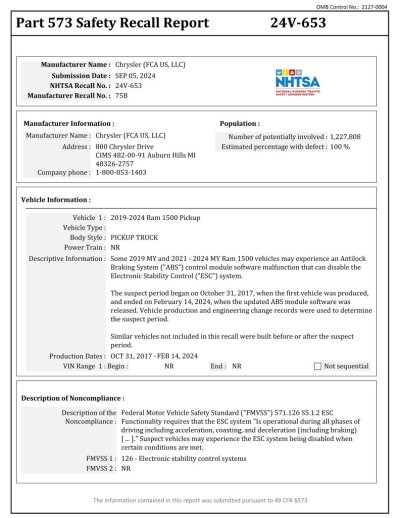

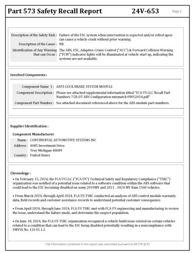

Also, I'm attaching the recall bulletin for anyone interested.
UPDATE: I called RAM to get some info about the recall. They said the software update is already available for newer trucks but not older ones. The truck I am trying to buy is a 2021, which the software update is not available for yet. I don't remember the exact year ranges for which have the update available and which do not. They also did not have a time estimate of when the update would be available for "older" trucks. They basically just said soon.
