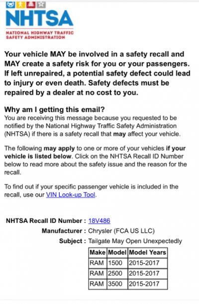

FYI I just received an email notice from NHTSA on the tailgate recall.
Now waiting for the letter from RAM.
SOB, I just had 2 recalls done and now another one. I guess we just need to wait till once a year and take it in and say ok, rebuild it.

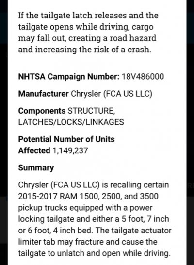

Recall is U74. "FCA US LLC is voluntarily recalling an estimated 1.1 million U.S.-market pickup trucks to upgrade their tailgate locking mechanisms.". Apparently this means they have an upgraded part that they plan to install.
  • U74_--_Tailgate_(Ram).pdf
