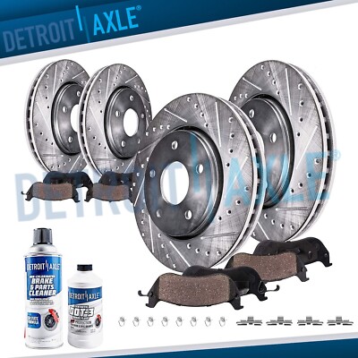

I'm going with these because I am a cheap skate. lol....
They are coated, crossdrilled and come with ceramic pads and made by Detroit Axle. Great price too!
Best regards,
-Mike
"Detroit Axle"....Sounds like something Harbor Freight would make up, which figures because it's China crap.
Ghost1500
Jun 2, 2022
180
256
Massachusetts
5.7L
I used them before and they worked well. I just posted it since the economy sucks right now. Whatever someone goes with really doesn't matter to me.
