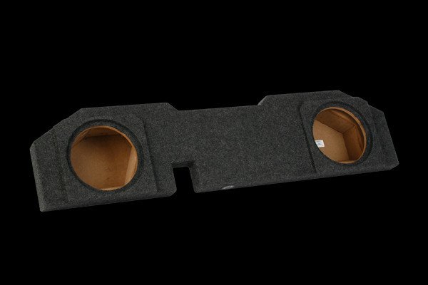

What I would like to do is keep the head unit in the truck and replaced the 6 speakers with aftermarket. Rears would be 2 or 3 way and I would put tweeters in the dash and woofers in the door. Then some kind of subwoofer under the rear seat.

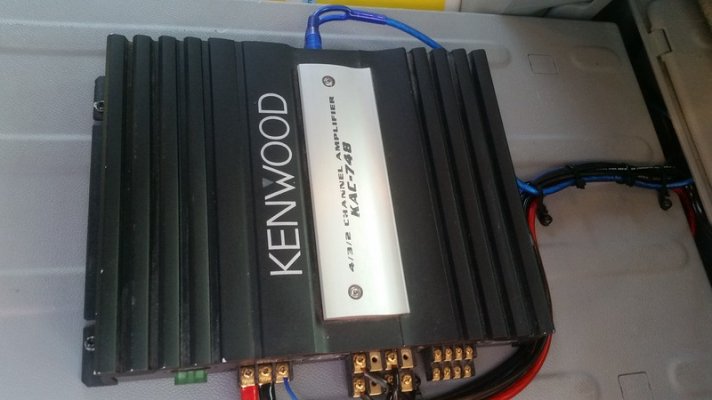

This is coming out of my current HHR which is being retired with the Ram coming in. The subwoofer is a bass worx box with 2 x 10" Infinity subs in it. The amp is a Kenwood running in 2 driver mode so a weird way to wire a sub:
I plan to use the amp to drive the 6 speakers (hopefully drive the tweeters and mids with a cross over or something) and then get a proper monoblock amp for the subwoofer or perhaps a subwoofer box with the built in amplifier.
Would this work? Does the headunit in this truck allow for this sort of thing with the required preouts?
Any suggestions for speakers which have worked well for some of you? Same for the subwoofer set up. Recommendations or model #s?

What about amplifying a 2 sub setup? Is this typically done with a monoblock amp or something in 2 channel mode like I am presently doing?
TomT
Jul 1, 2015
1,281
565
SoCal/OC
It would normally depend on if the two subs are sharing the same airspace inside the box or if there are two separate chambers. Subs are usually wired together and driven by a single amp channel like a monoblock or a bridged two channel.

My suggestion is to ditch the amp. Rated at 35x4 in 4 ohm or 50x4 in 2 ohm. Unless you find 2 ohm speakers. I think many infinity, jbl and some polk speakers are 2.3 ohm. You will need a line out converter to tap into your factory stereo output. You might even need resistors depending on your system.
Or you could find a 5 channel amp with speaker level inputs that puts out 75x4 and 500x1. https://www.sonicelectronix.com/item_100369_Pioneer-GM-D9605.html

My thought was to replace all of the drivers that came with the truck. Replace the 6x9 in the rear doors with an aftermarket alternative recommended from here. Door speakers would be replaced with a bass or bass plus midrange alternative. Then the dash speakers would be replaced by tweeters. This is similar to what I did with my HHR. I replaced all the factory drivers with aftermarket. Ideally I would use a dedicated amp to drive these speakers instead of the factory head unit.
Then either use the same bridged amp I have now in 2 channel mode to drive the subs or a new amp.

You could just leave the rear speakers factory and spend your money where you will hear it more. If you did that, then consider bridging your current amp to the front door components.

No budget yet. I guess ideally about 1000 if I can reuse my sub drivers and the amp. Interesting thought about using the amp on the front abd letting the factory head unit just drive the rear door speakers. Then I would be out for a mono or hard core 2 channel amp for the subs.

Ya, I would try that first. If you don't like it then you can put them in the sail panel. I would wire the subs together as a mono load to whatever amp you get.
