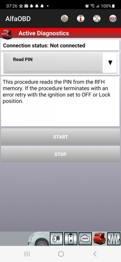

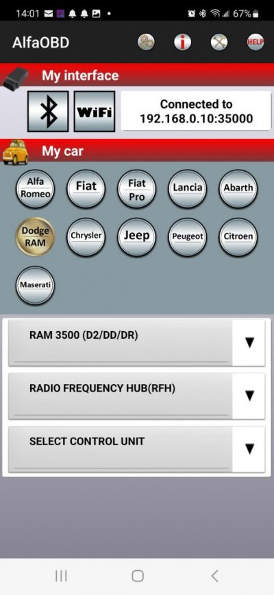

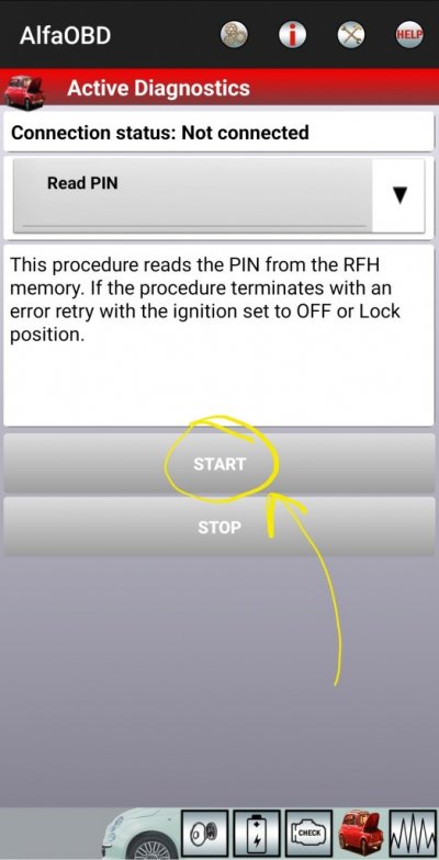

Could you please provide the path to this adjustment in AlfaOBD?
To get your PIN.
Select Radio Frequency Hub
Under control unit, select your model year
After you select Connect, Select the hood up Fiat icon
Select Read Pin
Select START and it will display your PIN

To get your PIN.
Select Read Pin

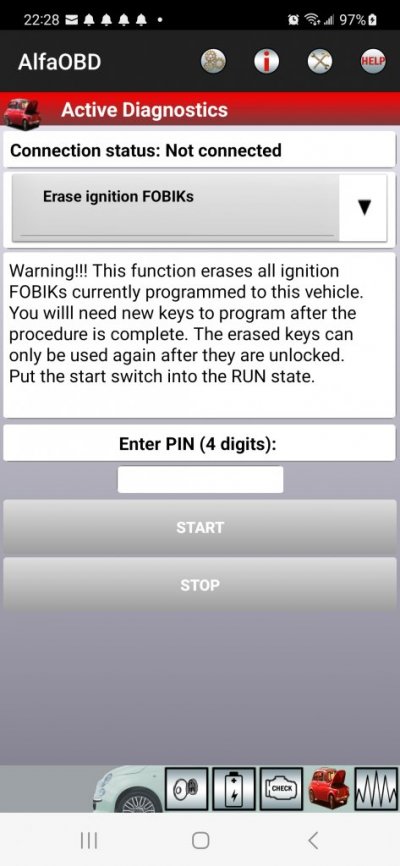

According to the Service Manager at my local CDJR dealer, once programmed, keys can not be deleted.

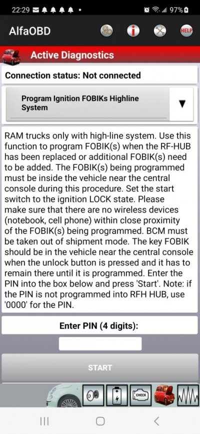

Sorry that's not true. You can remove keys with AlphaOBD and add new ones. But when I last did this you can also add back previously fobs that have been attached to a vehicle without the fob being unlocked/factory reset. Meaning that if a clever thief has your fob and AlphOBD with a OBD port tool they can easy add the removed fob you just removed (one they have in hand now that they stole it) to your vehicle because it's hard coded in the fob as well to your vehicle. New WiN module installed in your vehicle like mentioned before in this thread should keep that from happening I think since it will have different identifier being a different module.
At a min, you need to wipe all keys from truck and add the one in hand you have left back to car with AlphaOBD and adapter. I'd then add some new 3rd party fobs from Amazon that are new- how ever many you need. And don't forget the physical key blade in a fob....as your door is still keyed to that as well. Myself, I'd get new fobs from online and do alphaobd myself and then go to locksmith and get door and glovebox rekeys while taking new fobs in so you get all in hand fobs with physical blade keys in your fobs that work all redone. And then kill switch and parked inside if possible at night.
Or say screw it and trade it in and be done with it... :)
