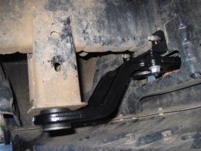

I bought a 2015 ram express 4wd a couple of weeks ago and realized there aren't any recovery hooks on it. I've never had to worry about this because all the 4wds I've had always came with them. So my question is ,am I able to install them on the truck at front bumper area?

Yes you can, they are close to the bumper but do fit.
I think someone swapped them from side to side for more clearance on the bumper.

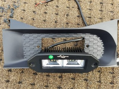

Do you have these covers in your bumper? I have no hooks so cut in lights but there are covers made for hooks that have factory openings
xxAGAVExx
Jun 25, 2017
18
17
Hmmm not sure. I will have to look. So the hooks may be there just have a cover?
No, if you don’t see hooks you don’t have them, there are just two types of covers. One solid cover if no hooks, and a cover that has a slot in it so the hook pokes out.
