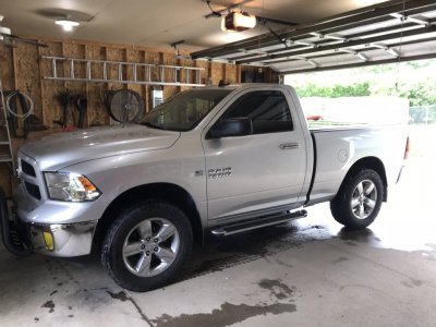

I've got mine set to 2.8" and the lift is right at 2 5/8" after everything settled in the front. I run 285/75r18's with no rubbing on a +1 offset wheel.

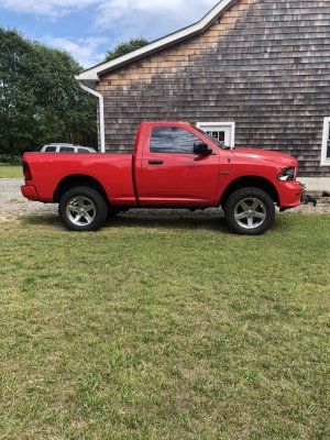

5100's use your factory springs so you get pretty much what Bilstein advertises. Springs are not universal OE springs are vehicle specific. I will say 1.4 rode better than the 2.1 I am at now At the 2.1 setting I have roughly 3/4" rake which is about what I wanted .

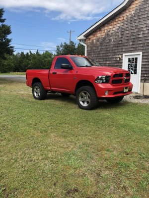

Thanks everyone for the pictures, might be a few weeks before I can get the bilsteins on my ram. will post be fore and after pictures.
