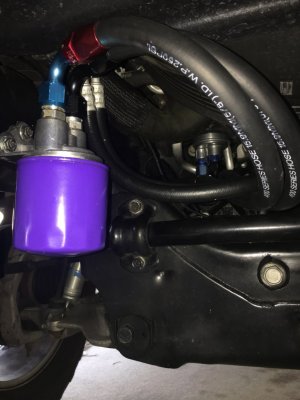

Finally installed my kit. -10 an fittings and nylon braid hose.
Running 50 psi hot
Idleing 36 psi hot
Running oil temp went from 212 down to 208 as well original pressure was 54 psi hot running and ~40 psi hot idleing
Also switched from redline 5-30 to PUP 5-30 so idk if that made a difference. A lot cheaper to buy PUP. debating on adding some 0-40 PUP next change in 10,000

so do we need 2 or 4 of the an to npt adapters?

how much hose did you use?

I bought all summit brand fittings and summit nylon braid hose

let me just say there is a whole lot LESS room on the 4x4 models when it comes to working on the bypass side. FAWWWWWK

The original posters truck Charonblks truck is a 4X4 ,my truck is a 4X4 , i'm failing to see where the differance's between 2X4 and 4X4 would make a difference in relocating the filter. What's this "bypass" you're talking about,there's 2 hoses to the relocation kit "In" and "Out", the bypass should be internal in the filter itself

Mine was 4wd and I had no issue at all I used 90s on all my fittings though so pretty simple to get an AN wrench and tighten

I had a bugger of a time getting the fittings tight on the piece that went on the original filter location.

never heard of an AN wrench until you said it. Probably would have cut my time in half.
