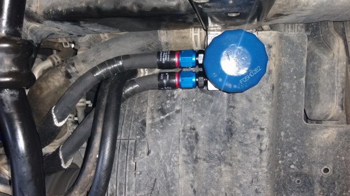

Hows it holding up now? Any pics or part numbers?
So Far not a drop

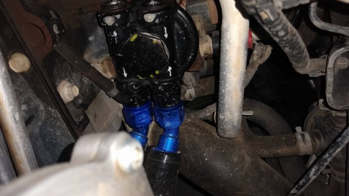

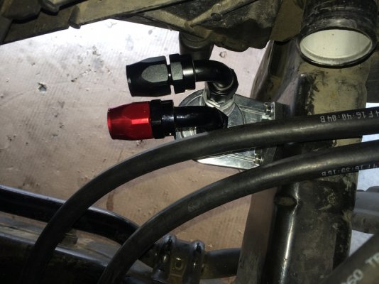

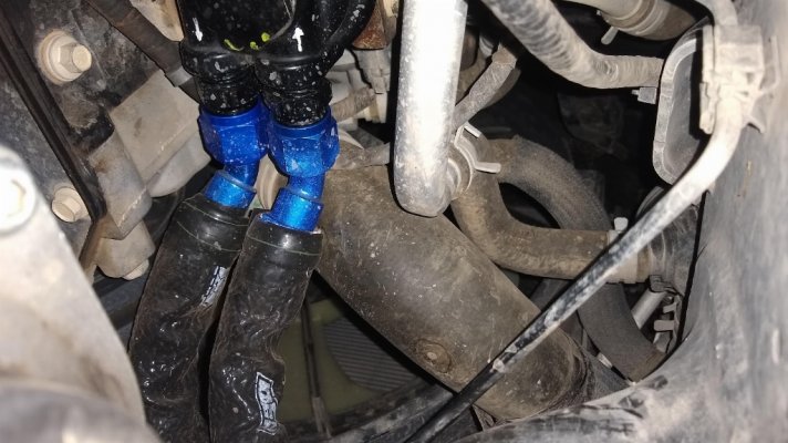

ENGINE SIDE:
Perma-Cool Dual Port Spin-On Oil Filter Adapter 3798
568-912V -12 Boss Viton O-ring
568-230V 2 1/2" Viton O-ring
2x RaceFlux 1/2" Male NPT to -10AN Male Flare Adapter Fitting
2x Redhorse Performance -10 45 Degree AN Push Lock Hose End - Blue
2X Gates 32925 PowerGrip Hose Clamp
REMOTE MOUNT:
Earl's Engine Oil Filter Remote Mount 2577ERL
FRAM PH2/FL-820S to PH8A/XG8A Engine Oil Filter Mount Converter Nipple
2X 2 of Aeroquip FBM1514 Size (10) Straight Socketless Hose End
3 metric screws (size 8 i think)
3 Nord-Lock Washers
HOSE:
Aeroquip FCN1006 AQP Socketless Hose 6 ft. Hose -10AN Hose
DEI Fireshield, leftover from a turbo project.
Things to note:
I didn't want to do this again so everything is NHSA approved brands.
I got new o-rings because Permacool provides Nitrile. Nitrile has operating temps of (–40 to +210 °F).
Viton has operating temps of (-15°F to +400°). Our engines run over 200°.
I hate hose clamps and are not necessary, but I used Gates Powergrip for appearance and assurance.
I changed the thread of the remote mount to maintain OEM filter sizes. This will make my life easier.
I tapped the frame to mount the remote. Used Loctire and Nord-Lock as additional locking features.
I did not use Teflon tape, I used Mopar anaerobic gasket maker. Expensive but works for pneumatics, hydraulics and rear main seals :).
Coolant lines get in the way. I used F4 tape to reduce abrasion till I can do better.
Parts do not come black. I had to powdercoat them.
Photos of old and new setup https://photos.app.goo.gl/8jwtARavqMtyPnHz2

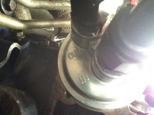

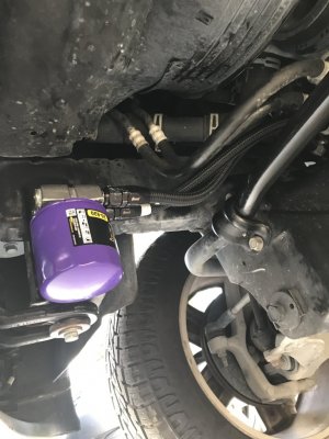

Alright, so finished up the oil filter relocation kit, I was getting angry about getting oil all over my rack and front cross member every time I change the oil, the filter's also a PITA to get to so I wanted an easier place to get at. I know there's lots of tricks to getting the filter off without any mess but the location is still a PITA and I change the oil very regularly with my setup so I want simple and easy. It was pretty straightforward to install, tool requirements were very minimal: a drill, 5/16 drill bit, ratchet with socket (or flat head screwdriver bit), and a crescent wrench (or proper sized box-end).
I used the Tansdapt 1127 remote filter kit, it's not listed for the Ram, but the filter kit works perfectly since we have a 22mm x 1.5 thread pitch with a 2 1/2" ID filter flange. I got my kit from Jegs for $70, very reasonable price I think.
Now, the kit comes with all the hoses and fittings to install everything except the teflon tape for the threaded fittings. Since I'm a stickler for how it looks as well as how it functions, I changed out the brass fittings for some 90 deg -10AN fittings and some Hose Candy hose wrap to clean it up for a better looking install. If you don't care about looks as much, the install is the exact same, just use the supplied brass fittings instead of the -AN fittings.
I installed the remote filter base vertically on the passenger's side inner frame rail but it can be installed horizontally as well with no issues if you want a cleaner install with the brass fittings. I made a paper template of the filter holes and transferred it onto the frame rail then drilled the 5/16" holes and used the ratchet to tighten it to the frame using the supplied screws. I tightened the 1/2" NPT to -10AN fittings into place before installation because of how close I wanted it to the radiator. 90 deg fittings in place just for clearance testing
Then I installed the filter by-pass base onto the block's oil filter mount. This just threads into place, the instructions say that if it doesn't thread on all the way that a few threads will need to be cut off the factory nipple, but this wasn't required. They say to just tighten it as a normal oil filter, but I did take my filter wrench to it to get it the last full turn since there's less to grab compared to a normal filter.
Both the bypass base and the remote base are labelled for the hoses IN/OUT so it's not hard to set it up, but I still managed to do screw it up the first time.
I attached one set of fittings to one end of the supplied hoses, I then attached the hoses to the bypass base and laid them out to get the proper length, marked them and cut them. I then installed the hose wrap and the other set of fittings.
Install the OUT hose from the bypass base to the IN on the remote base, and the OUT from the remote base to the IN on the bypass base. So easy I managed to screw it up, I know.
After all is said and done, I installed a new RP oil filter. It should be noted that the remote base does not use the standard Dodge 22mm x 1.5 oil filter, it uses the more common 3/4"-16 filters which happen to be cheaper too.
Once it was all installed, I fired up the truck, had zero oil pressure because I'm an idiot. Swapped the hoses on the remote filter base and retried, oil pressure jumped right up and all was good with the world. Once I shut it down after running for a while, I checked for leaks, had none, topped up the engine oil as required. My oil changes will now need 7-8 quarts instead of the normal 7 to account for the additional hoses and filter volumes.

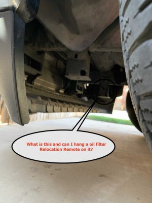

Will someone tell me what the two posts on front of frame behind/under radiator are for?
Can I hang a bracket off the passenger side under radiator and behind the front bumper for the oil filter relocation assy on it?
Is it used for some type of maintenance/alignment? Potential OFRK Remote install.jpg
crazykid1994
Sep 21, 2013
5,063
5,064
Florida
Is it used for some type of maintenance/alignment? View attachment 182437
I believe you are talking about where the tow hook mounts

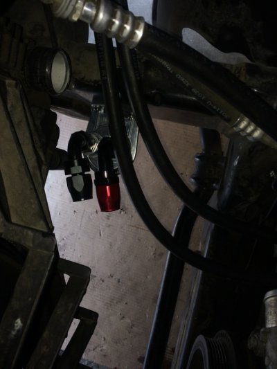

I got started today. I'm waiting on AN10 Black SS tubing. I installed the Remote Base today. I installed with some 1/4"x28 x 1 /1/4" SS Bolts and Chinese lock nuts. I'm gonna use 90 degree AN10 fittings on the Relocation base and 45 degree AN10 fittings on the bypass base. Just waiting........ While I'm waiting here U go!
