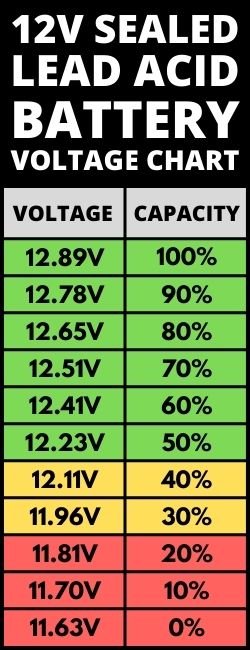

Let me try to write this more slowly, Low battery voltage will stop the remote start, even though the truck will start fine with the button. It remote starts fine after that for the rest of the day because the battery voltage has come up.
You read 12.4 volts, that is too low for remote to work. Once you start it and shut it off again, and the remote is working, check battery voltage, my bet is it is 12.6 or higher. You either have a defective battery or a parasitic draw over night.
Sorry, I was posting reply while you sent battery voltage chart reply. I thought 12.49 volts was enough voltage to start with remote start function, but I see that 12.6 is resting volts on battery.

No problem, there is a lot of information being provided. I have posted this same stuff about batteries and voltage at least a half dozen times since it started to get cold. If you read the threads directly below you will find your questions have been answered many times. Well worth the read time. Best of luck, let us know how you make out.
Thanks, I did not think 1.1 volt would make that much difference, but it must. I will know for sure after trickle charge test.

It isn't actually just small drop, even at 12.6 you are only 65%, at 12.4 you are actually quite a ways off 100%. You can know for sure by measuring the voltage on the terminals after the truck has been started the first time. If it is now 12.6 or higher that answers part of the issue. Your trickle charge test will just be double confirmation and is a very good idea.
