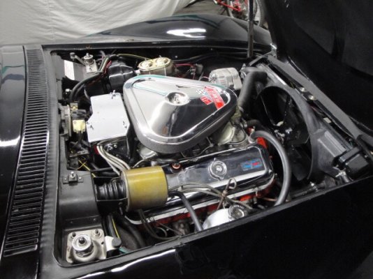

Anybody who's into racing their trucks usually removes the engine cover.Mine came off the day the truck came home,plus I think the engine isn't a bad looking engine,and to me the cover actually detracts from the looks of it.It's not as good looking an engine as an old BB Chevy,but it's still a decent looking engine in my opinion,lol
Yeah, those old big block Chevys are hard to beat

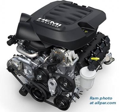

Maybe fuel efficiency where you live, here its 94 degrees today so if anything its just holding the heat in. Hell I never even saw a plastic cover on an engine until maybe 20 years ago when the LS engines came out. Like I said earlier the 6.2 and 6.4 HEMI's don't have engine covers so you will be fine without one. I wash my engine at least once every 90 days so it doesn't have much of a chance to get dirty.
