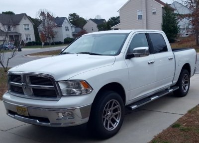

I thought upon seeing all of you gents and your sharp looking lifted Rams that I wanted to be on that playground. I had a level installed in the beginning of the summer to get rid of that dreaded rake. But upon reading and researching, it would appear doing that would more so hurt my truck as opposed to help. So I ordered a set of the Bilstein 5100 level for the front.
I was going with a 6" lift but honestly it's really not for me. So with that being said. I'm going with a 4" lift in January and am sticking with my current wheels and tires. My question is will I be able to keep the Bilsteins when the 4" lift is added ?

Yes, as gasser said, you will definitely want to use the Bilsteins with the lift to level it out.
Have you installed the Bilsteins already or are you going to just install them when you do the lift? What lift kit are you planning to go with?

I'm going hopefully with BDS for the 4" and I have no problem grabbing another set of wheels and tires. I just don't want to look like I spend majority of my time off-road tires wise lol.

Depending on the rear lift option you go with you will want to use the Bilsteins for sure. Set at either 0.7" or 1.4" depending on the rear lift setup and the current measurements of your truck.

I've got the Zone 4"F/3"R kit with the Bils set at 0.7" to leave just a little rake for when the truck is loaded. Zone is the sister company of BDS. Don't get me wrong, BDS is a great kit, but if you really don't go out and pound it in the dirt, you can save yourself a nice chuck of change towards some bigger tires. There are a number of AT and HT type tires that don't have that serious offroad look to them. The Pirelli ATR's are one, and Nitto makes a couple that have great street manners, with little road noise.

Technically if you do a 4" BDS or Zone and have Bils set at 2.1 you end up with about the same height as their 6"front/3"rear lift kit.

My current tires are 275/60/20 Michelins..

This is how I'm pricing it out, hopefully I can still use my nib Bilsteins with it.

You'll be able to use the Bils no problem. Check out auto anything, I keep getting 20% off emails............I scored a 4" lift for $1079 shipped to my front door
