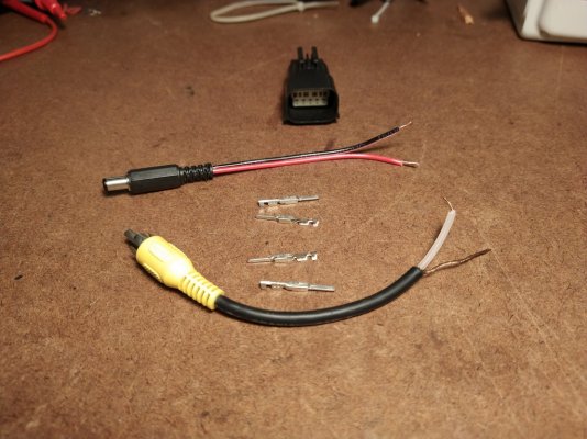

Then I went digging through my parts supply for a power connector and phono plug that matches up to the camera that I ordered. Here are the parts laid out ready to go:

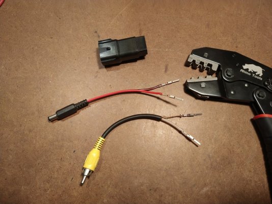

I am not going into details on the crimping and putting together this style of connector. Hopefully someone else has covered that. You have to crimp them well for them to fit in the appropriate holes and lock into place. My goal here is to document that this is doable and provide the appropriate pinout. Here is the connector with the pins crimped on.
