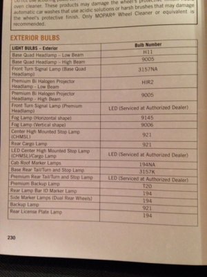

Ok. I'm confused. I already switched my fog light bulbs to PIAA extreme white bulbs and want to do my low beams. When I go to advance auto site it shows H11 and 9005 for my low beams. I am assuming 9005 is my high beam and the H11 is the low beam. Correct? When I go to amazon to buy them it says both don't fit. WTH! I have a 2016 Laramie with factory projectors. What bulb fits my truck
Thanks!

those are the bulbs for quads.... look in your owners manual for a list of bulbs for your truck. here's the page out of my 2014 manual for my truck. Should be HIR2 for low and 9005 for high if it's still the same for 2016 trucks.

I try not to trust the Amazon system too much at all... I've bought things that said wouldn't fit that fit just fine. So I'd find out the part number somewhere else, like this forum, and just make sure that it's the same, then ignore what Amazon says. In my mind, it's not trustworthy enough yet.
