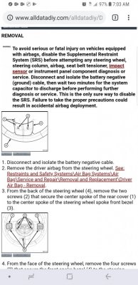

I have decided to replace my CC switch. If the temp is below 75* it won’t turn on. Does anyone have a service manual instructions on how to replace the switches on the steering wheel?
