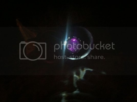

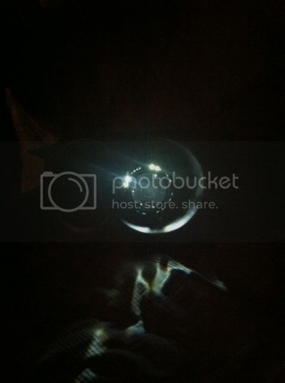

Been working on them for awhile and will be quite awhile till I can install them
Here's what I have so far
Satin black bezels, tinted reflector, color matched PDM turn signal bulb covers, mini h1 6.0 projectors, PDM and PXR black gattling gun 2.0 shrouds
Will be installed with 50w morimoto ballasts and 5k bulbs
Since they are actually my girlfriends Christmas present I'm going to try for pink devil eyes
I had some ideas for DRLs and secondary running lights/turn signals but that's getting ahead of myself
More pics to come as progress continues
