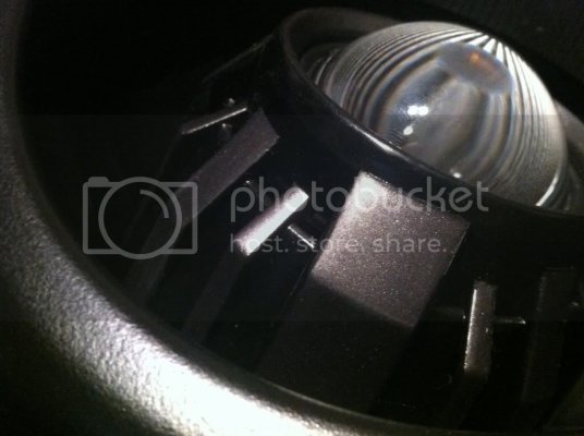

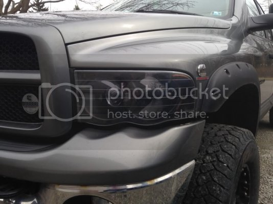

I used Eastwood 2k clear coat on the shrouds and a grille I painted, awesome stuff

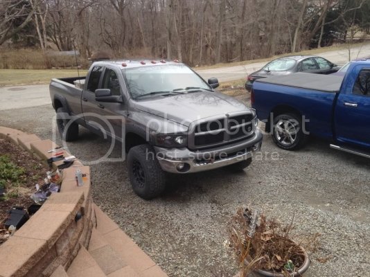

I started to install the harness last week and it started to snow so I pulled it all back out

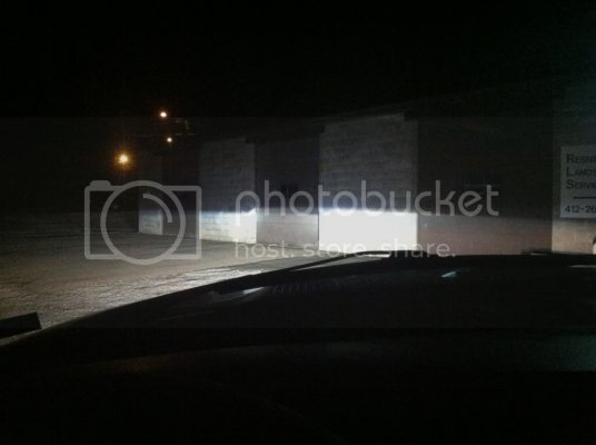

I got everything in last night, leveled the cut offs, went inside to seal them back up and came out to it raining (it was also 2:30am at this point)

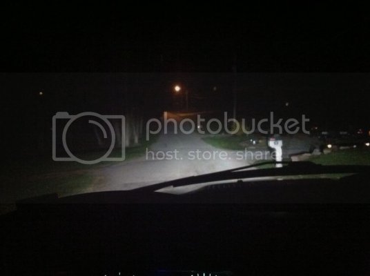

I didn't get to hook up the LEDs but the HIDs work for the most part
The highs/lows are opposite of the indicator and the passenger side cutoff is higher then I'd like with the adjust maxed out ( had to swap the adjuster from another headlight to this one, I believe I have to open the light up again and back one of the bowls screw out some to get the cutoff where I'd like)
Only day time picture I got as I was leaving this morning
