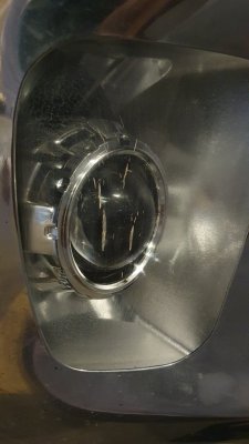

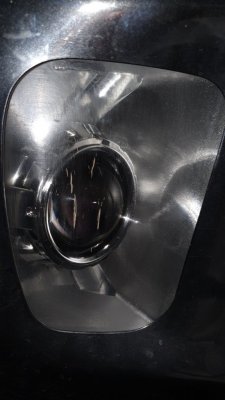

thankfully images worked out. as you can see i tried sanding and polishing but did not have all I needed and decided to leave it for later.

Looks like You burned the plastic. I can also see the cracks so I would suggest watching your heat. Also you can use thick butyl rope to add some height to the lense which could help you out with extra space. Maybe the cheap replacements will be easier to mold. I have never done the OEM fogs for this reason as they are nicer than the aftermarket and more $$ but they are also harder to open.

Sure I did. The cracks were there before, I just made them bigger.
I tried on the OEM as they have already been through a couple of sand storms ( Saudi Arabia ) and were very hazy and loose, so I figured I would go for it.
