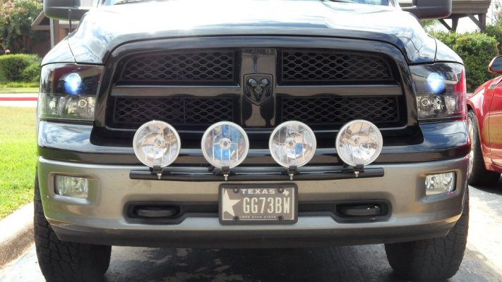

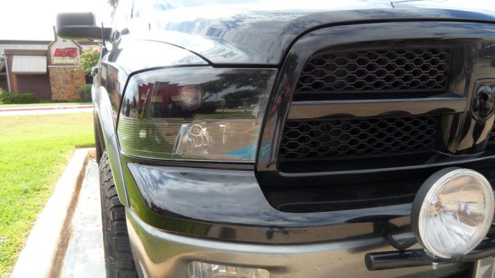

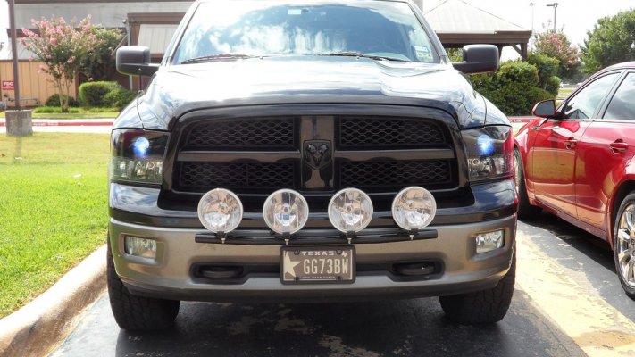

I sealed these back up this past weekend, and I installed them Monday night. i decided to get a few pics for you guys.... I have 6000K Morimoto HID bulbs in these. The cutoff line is awesome, and they turned out great. I am very pleased with the outcome and the resulting look of the truck will the whole light black, with the exception of the high beam part. Love it.
I used Morimoto Minis for the projectors. Here is the original build thread.... Projector Build
I'm thinking about doing the fogs next!

I did them myself. I had the headlights, sanded and painted them.
The Morimoto units are about $100. The bulbs were $25. I already had HIDs so I had the ballasts etc.... just needed new H1 bulbs.
Doing it myself, it was less than $200.

Now the fog lights stick out like sore thumbs!! LMAO!!!
I need to do something to those quick!! Maybe I'll do some Lamin-x for the time being.......
Need to get some cash together and get started on the fog light conversion.

Looks awesome bud. I have the same issue with my fog lights lol. I do have the Lamin-x but after awhile it turns color and makes my 5000k fogs look yellowish like a stock halogen bulb. So I need to do something about that.
Very clean and professional looking install man. Again, good job
