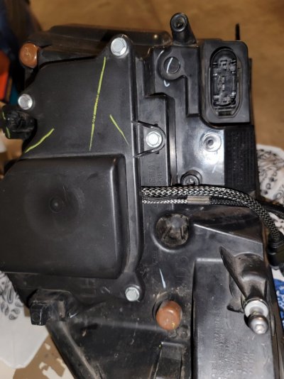

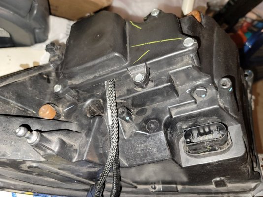

Inside of the headlight I now keep the ignitor as well as the High beam LED capacitor. I used a dremel to run the cables below the cap. A little dab of clear silicon keeps it sealed.
Pic with the cap sealed.

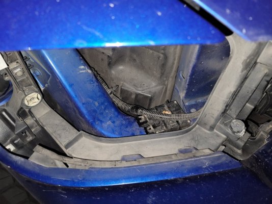

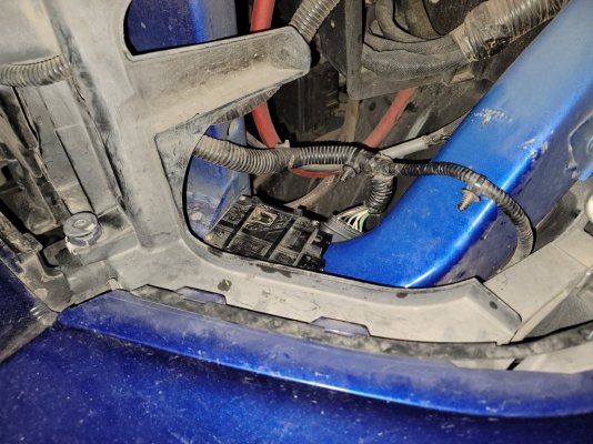

Then a couple of where I keep the ballasts.
Passenger
Driver.

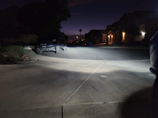

Better late than never.
Various angles.
Passenger side

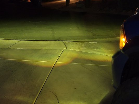

Fogs only. Morimoto LED w Lamin-X yellow tint. They have excellent cutoff so your not blinding people.
Brights are friggin' insane!!!
Full setup. Morimoto HID's 5000k bulbs, new ignitors, Morimoto 3 year old 35 watt ballasts. Morimoto LED 2.0 stroke high beams w decoders installed.
