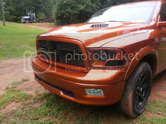

I'm going through this right now and am actually using a set of Duals that I picked up. I tried it first with my Quads and it didn't work out so well for a couple reasons. The stock Quads are perma-sealed together which makes it a HUGE PITA to open them without messing them up and the shape of the quad won't allow a decent projector to fit in there.
You can get an MH1 in there but it's not the best projector and with some cutting and a small shroud you can fit a D2S in there but it's not pretty. I'm finishing mine up now and am so glad I went with a set of duals. Got a D2S with a Panamera shroud to fit in there nicely.

Yea the duals you can fit the D2S projector in nicely plus better shroud choices. To me a retrofitted dual looks better than a retro'd quad.
