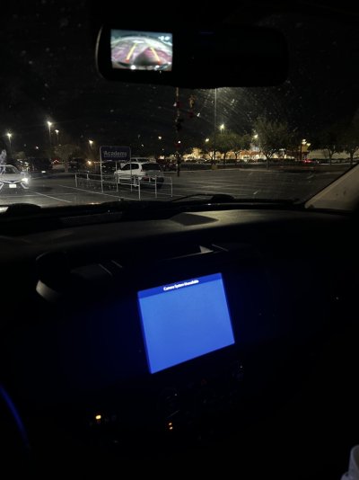

I upgraded to the 8.4 but I have the reverse camera on my mirror, now that I upgraded whenever I go into reverse a blue screen shows on the 8.4 is there a way to stop this from happening? IMG_8580.jpeg
Take a look at this document. I installed their jailbreak on my 2015, and following this guide, I was able to duplicate the RVC on the 8" display.
