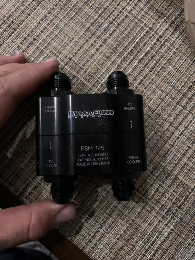

Had weather down in the upper 40s here (cold for south Florida…) and the trans would barely get to 100° and wouldn’t maintain anything over 100° unless I was driving on the highway. So decided to try something and parts have started to arrive. I will be installing a 145° inline thermostat. Need to get a proper caliper to measure the OD on the trans fluid lines. Seem to be 1/2” which is recommended to use -8an tube sleeves and nuts. Parts should be here sometime in February but the thermostat has already arrived. Comes with -10orb to -8an fittings. I will be flaring the hard line on the trans to connect to the thermostat directly to try to reduce any chances of leaking.

I'd use a ferrule compression fitting on the cooler lines Kris,then make up short flexible lines to connect everything together.
These are overkill,but should never give you any issues with leaking.

As nice as those may be I’ll be flaring the lines for a hard connection instead of a compression fitting. May still end up using short sections of hose depending on where I finalize my decision to mount the thermostat.

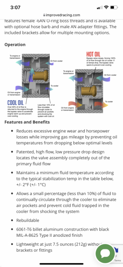

This is not able to fail completely hence why I chose this one. If it fails it closes the bypass. There is no restriction on this thermostat. Take a look.
https://www.improvedracing.com/compact-high-flow-engine-transmission-oil-cooler-thermostat.html

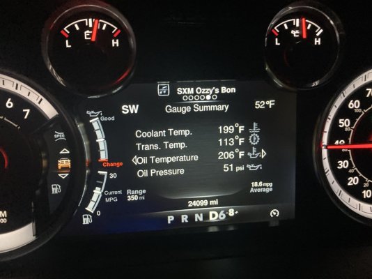

I wish I drove my truck more, been just as cold in Tampa area the last few days to see what mine does. I left the heater, used the block plate and the few times I drove (stop and go traffic, US19 in Pinellas is miserable) it when it was mid/high 50s last week I had no problems getting the trans temps into the 120s (if I remember correctly) but I also tend to drive that thing like a bat out of hell, too much fun not to :shrugs shoulders:
I'll pay more attention these next few weeks cause the temps are supposed to stay down "low" for awhile and I'll drive normal and see what they do. Maybe with the heater still attached it's enough heat to transfer when really cold to get temps up more than with it completely gone?

I see having the heater even with the bypass does proivde some heat to the fluid.
It was 35* this morning and it got into the 130s are so after a 30 minute drive.
I still don't like how jerky the trans is it when it's in 4th or 5th. You let off the gas and coast for a little bit. Then get back on the gas. Definitely not smooth.
