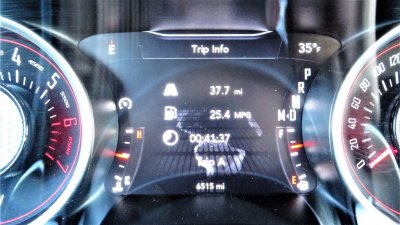

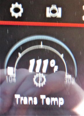

Took the wife out for supper tonight,we weren't in any rush and we were on 2 lane back roads,so i had the cruise set at 90 kmh's roughly 56mph,our favorite little eating joint is about 40 miles away,tranny just barely got over 110f in her car.

Last night i was more interested in seeing where the cars 8 speed ran for temps,if i was babying it,basically driving it with an egg under the foot on the skinny pedal,to see if 130F is to cold for the 8 speed,by the looks of it,i think 130F might be closer to an ideal operating temp for it,as the car just barely got to 111F when i was babying it for 40 miles.
