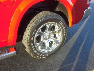

This tire is a Cooper AT3, 275/60/20s, it measures 33 inches tall, look how small it looks in the wheel opening.
I laid a level on top of the tire and measured to the concrete, 33 inches.
You will have no problems with the size you want to use.
