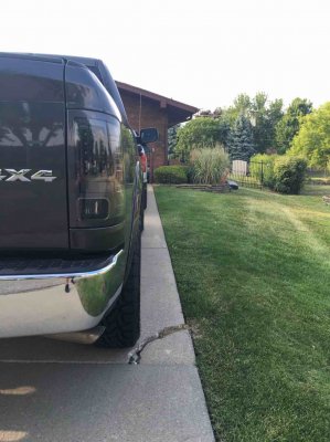

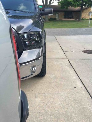

Completley off topic but those tails look really good on your truck.
A +1 with 12.5 wide would prolly get your tires to stick out .75 to an inch. I've got a 11 wide on a 34 stock suspension and no trimming. There are a lot of examples in the mega bilstein thread that has a lot of info that can help. Lot of those trucks are lifted 2.8. Also there's a lifted thread too that you can find lots of examples.
View attachment 74153View attachment 74154
Sorry op...carry on!
