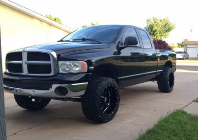

This is how mine looks. 33x12.50r20 on 12" wide moto metals. -44 offset
How far do they stick out? Got any pictures of its straight on so we can see the full effect of the offset

I don't have one straight on, and unfortunately I won't be able to take one for a few days because I'm in the middle of a rebuild on my entire front end. But this is the closest I have that should give you an idea. They stick out about 2"
Love that set up
