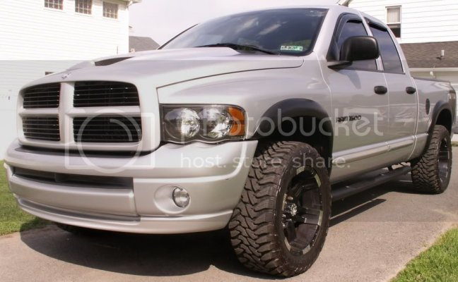

can you post a pic. Ive seen some pics of guys with coopers on factory rims and back spacing that didnt stick out but half inch if that.
Here you go

in that pic i did have the torsion bars cranked, but when i first got the tires the suspension was stock and they didn't rub.
tire size is 33x12.5x20. 305/55/20 is real close to that

Since you have an 04 they will not rub on stock wheels
