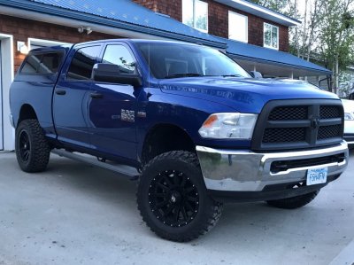

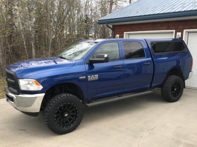

Finally got to it. Have 3.5" up front and 1" in the rear. Running 20x9.5 w/-12 offset and 35's. No rub at all and just enough hanging out to look aggressive but not foul the side all up every time it gets a little muddy..... Thanks for all the info!
