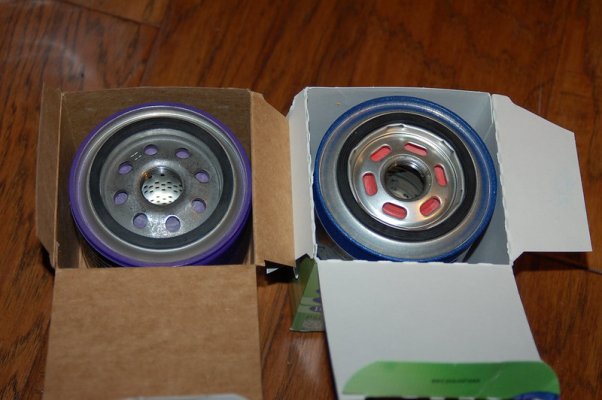

Since I did have a lifter tap on a filter I would say it is actually possible. Changed to a different filter tap went away. The filter that caused my tap was purolater synthetic, only changed the filter to a Royal Purple and tap/tick went away. Of note, also purolater yellow my truck did ok on, it was just the synthetic. I posted pics as well, the issue was the filter holes in that particular filter. I would say it sucks that rams are so sensitive in this area, but the fact does exist. Look at the difference in the holes, guess which filter didn't knock, yes the one on the left, RP great flow.

Post a pic of your filter like mine above, maybe the lack of holes is the issue. I seriously doubt it is the media.
Interesting since both of those probably have equal total hole size. Did yours tap from the 1st day of installing the filter on the right or did it take a few thousand miles?

Tapped the second I put it on, and stopped the second I took it off. I'm pretty sure it is in the begging of the Syn thread as I have posted everything. The inside holes, or the cage that holds the media together, are not equal hole size. The puro was seriously lacking and showed up immediately in the lifters. Unfortunately I didn't look at the holes in the puro yellow to see if the holes were the same, again that filter did not have lifter knock.

All the more reason to relocate the filter and go with a much larger filter.
