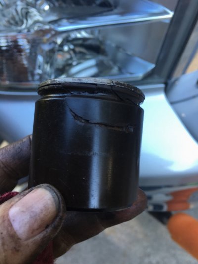

muddy12
muddy12
Jul 26, 2016
1,030
803
Indiana
Figured out why the passenger side locked up.
Broken caliper piston.
Prior to it seizing, there were no indications that there was a problem.
