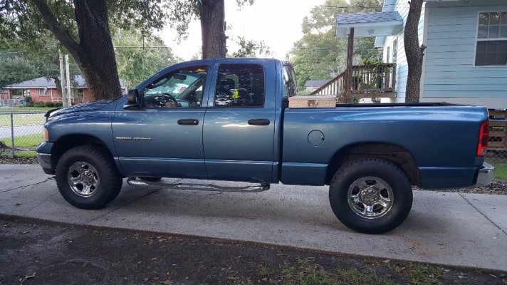

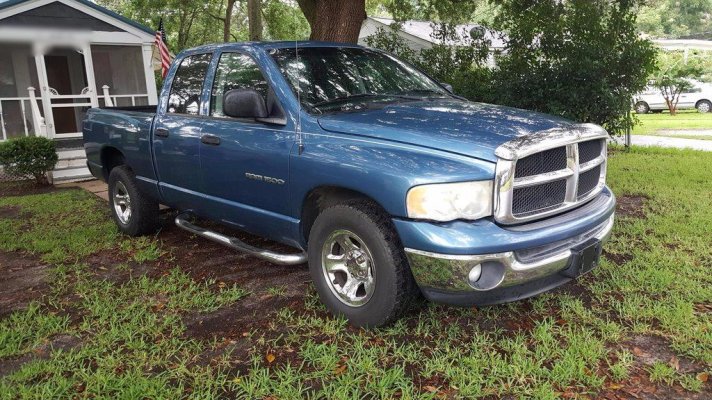

BEFORE, stock 2WD with 265/70 tires
AFTER. 3" Rough Country, 305/70 Nitto Terras
