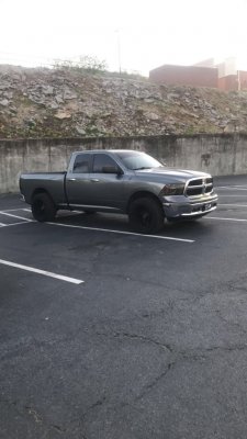

Okay, so Im planning on buying a rough country lift kit either a 4 inch lift or 6 inch lift. Im leaning toward the 4 inch lift because I heard the 6 inch lift is pretty much a 4 inch lift with a 2 inch leveling coil spring to bring the front to 6 inch lift total. So what im asking right now is should I just get the 4 inch rough country lift? because I already have a 2.5 inch Maxtrac leveling coil springs right now so it will probably bring my truck to 6.5 I believe. Here’s a picture of my truck right now with the maxtrac coil spring

I think if you go with the 4" ... you will still need more spring for the back

You'll need 5 inch rear for 6in lift.

The Rough country 4" kit has spindles for front & spacer for the rear .............
