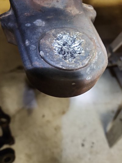

Yes it is stock. I have been very busy with work so I parked the truck. Last Friday I moved my tire and saw little movement so I took everything apart and got to the ball joints. The upper was still tight as I tried to move it but the lower I could use my finger and move it all around freely. Spoke to RAM Mechanics and they agreed that was the problem. Now, the POS is froze in there and after trying to use the ball joint tool to pop it out and all it did was push the top in. I have tried to heat the ball joint and axle to no success. The only thing left to do is to try to blow it out with a torch. BTW, there is no snap ring, verified that before I even attempted to use the joint tool. This has turned into quite the project for a 45.00 part. Any advice would be helpful. I also tried to use an Air Chisel with a flat round bit.

crazykid1994
Sep 21, 2013
5,063
5,064
Florida
Dumb question but are you sure you’re not pushing the wrong direction?
