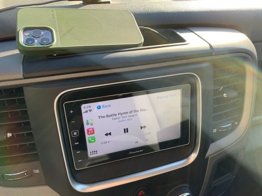

Just install in an aftermarket CarPlay/AA-compatible head unit. I had the small LCD screen radio in my previous 2015 2500 and swapped in a Pioneer unit that worked great. Only downside was it was maybe a 6" screen, so not as large as the 8" RA3/RA4.
I agree with the others about the unit you linked…
