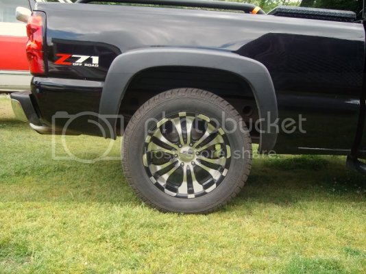

Same thing we get over and over, if you are looking for a great street machine 20's is the way to go, but the guy wants old school TSL super swampers so he is looking for a 4x4 look and probably function. One is better for the street and one is better for offroad. Below are the same size tire 33, and a 17 and a twenty. The 20 is not a good offroad tire because you cannot adjust the tire pressure for the trail. Doesn't have enough side wall, so you will be riding on glass and full pressure or riding on the rim if you lowered the pressure. Anyhow, I don't think the OP cares, he just wants his 16's, and if he can get them it will be a great option for going offroad.
