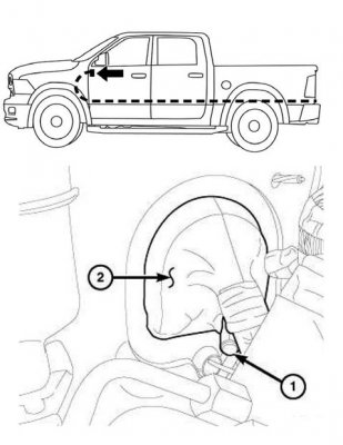

First, wire loom the whole thing. Then route it along the drivers side of the car, starting along the factory wiring behind the rear tire, once you get to the rear tire, just follow the parking brake all the into the cab. Zip tie every 6" or so.

I started by crawling under the truck to look for grommets that were not being used. I have a regular cab, but I did locate the one mentioned above under the seat. I thought about using that one, but I really wanted one closer to the radio destination.
So I popped the hood and looked at the engine on the driver side and struck some luck. Looks like I had a hole that was plugged with a wide plastic piece. I'm not sure what option the hole was for. But I took a drill and poked right through it. I ran the wire through to the new hole and it came into the truck above the feet area. It was an easy run from there to the radio. I ran a second cable from the there to the radio as well in case I decide to add a second front camera later (pioneer can support up to 2 cameras).
From the engine I ran it behind the battery and down in front of the driver side wheel well. From there it was tucking it back behind the wheel well and zip tying it off all the way down the truck. After that was done I had to wire power to the license plate camera. I've seen many posts and a few videos of people using the reverse wire in the hitch. I looked at my hitch wires, but decided it was easier to pull the tail light. So a couple of screws later it was off. I peeled back the harness wire protector and stripped both the positive and ground wire back on the reverse light. wrapped the positive and the negative around the respective wires and soldered it, then wrapped it all up in electrical tape.
