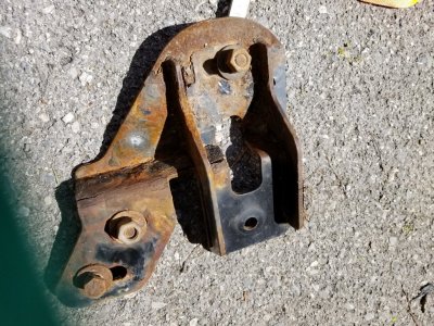

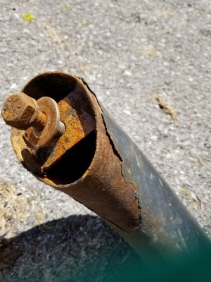

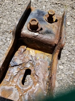

I had bought and installed a set of Westin Platinum Oval step bars. They were on the truck for 7 years and now they have rusted pretty badly. They have also caused some rusting on my truck where they mounted to the frame and in the cab corners. I was wondering if all steps/running boards mount the same way or how I can get around this rust issue. I am taking the truck to have the rust fixed and I don't want to have a repeat problem.
I have found out the these steps have an issue that water seeps thru the holes where the rubber step pad attaches and they hold water and rust from the inside out. So most likey I will be looking at a different model to install.
