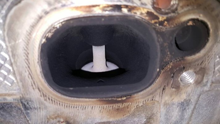

I think im running a little lean, in all my years of working on cars i have never seen valves look like this 2621cbb87bb760fb2641acb105485704.jpg

It might be because your exhaust was leaking?
KingTuna
Oct 23, 2015
124
52
3.6 Pentastar
I think I read a post on a mopar forum I'm on about someone pulling the heads off their 360 that had been rebuilt about a year prior. The valves were white like yours, but the pistons/cylinders looked good. I think someone else said it was from the ethanol in the gas?
Dubstep Shep
Aug 4, 2014
2,240
514
Houston
2014 R/T
Good point.... but wasn't too bad of a exhaust leak. I think I may go buy a bore scope and look at the other side and pull the plugs
If you have an android phone, they make borescopes that hook up to it. Heck of a lot cheaper than the real deal.
Uh, what? Why would ethanol do that? Most modern cars run better on E10 than they do on 100% gas.

I've fixed many Hemi exhaust leaks and the exhaust valves always seems to have that appearance to them.
MADDOG
Living in a Firepit
Dec 26, 2011
15,168
11,384
Arizona
6.4L HEMI
If you are running a stock program, I can guarantee your engine is running lean.
Tach_tech
Jun 1, 2014
3,320
3,595
5.7L HEMI
This is 100% true. Factory programming is as lean as possible. That doesn't mean it's hurting you're engine though. All about emissions.

Im running a tune. Once i pull a spark plug i will see if this is existing prior to tune or current effects. Tune and plugs went in about the same time.

How would an exhaust leak do that? I only ask because I just notice I have a leak.
R/T_Fire
R/T_Fire
Feb 3, 2015
3,432
1,207
Pleasant Grove
It will lean out the motor cause the O2 can get a faulty reading changing how the engine fuels based on that info.
yoda
Jul 25, 2016
460
266
An exhaust leak before the o2 sensors will actually cause the engine to run rich.
The O2 sensors read the extra oxygen and the PCM interprets it as a lean condition. Causing the PCM to add fuel.
Picture of the exhaust valve looks normal to me.
R/T_Fire
R/T_Fire
Feb 3, 2015
3,432
1,207
Pleasant Grove
Depends on engine temp and intake air temps, but yes you are correct in many cases
yoda
Jul 25, 2016
460
266
How so? I can't really think of any scenario where an exhaust leak will cause the engine to run lean. At least not on a Dodge speed density fuel system.

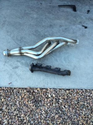

This may be an issue.... looks like a trip to the machine shop is instore
Sent from my SM-G920V using Tapatalk
Csanders1992
May 9, 2014
1,368
370
Possibly. But it's hard to put faith in that measuring tool. But I would still have it checked out
R/T_Fire
R/T_Fire
Feb 3, 2015
3,432
1,207
Pleasant Grove
It rocks on my flat welding table too... this was just a good way to show the gap in a picture. Also not the only tool i used to check how even the surface was.
Hipps2000
Jan 15, 2014
897
407
2013 Ram 1500 Bighorn
Hemi 5.7l
Throw them in the garbage and install ceramic coated headers. Stock manifolds are garbage.
