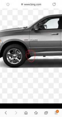

There is a spot between your front fender and the front doors. You have to take out the wheel well but lots of debris gets stuck in there at the bottom where the wheel well piece sits.
I would get the debris out as mine was full of mud and leaves.
