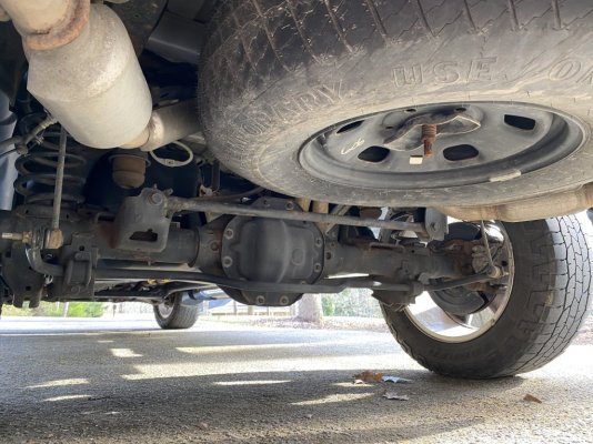

My 2017 spent 4yrs in PA and 2 yrs in northern NC before I got it. It's got surface rust underneath but nothing worrisome. I think the spare tire winch may give me some issues but otherwise, it's not bad. I've got some rust converter from Eastwood I plan to put on there when I have time
