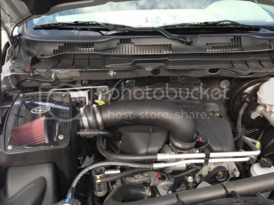

2012 1500 Big Horn
Got my S&B installed with 180 Tstat, Corsa DB exhaust, and Hemifever tune, had efan but they shipped wrong one so waiting on correct one to get back, truck sounds great and runs even better thanks to Sean at Hemifever, and Moe's for awesome work and help well I was deployed.

nice...with all that i bet it really woke the truck up

Quite a bit!! I lifted at the same time and waited till I back to VA from NY to put rims and tires on, and it was a beast for the drive back home and was getting hand calculated 20.5 mpg on highway. The Rim's and Tires calmed it down but mileage is still great too around 18ish highway and 15.5 mixed, I only have 3.55's though wish I got the 3.92's but oh well, cost to must to change at the moment, so maybe just a S/C will wake her up and give her some pep back in the future.

Nice! Sure was a lot of mods all at once! Awesome

Sweet mods. As mentioned above....truck should have woken up a tad ;)

She sure did wake up! Sounds so amazing now, the intake sounds amazing as I did that and t-stat and then the next day exhaust. But that Corsa is sound all in its own, so wonderful! No drone inside ever, but amazing outside/behind and especially when I get on it! I'm more than happy with it! So now I want long tube's maybe a cam and a RIPP i think or pro charger, I just worry with offroading with a procharger and being A/A if the stoping and sitting at times will hurt along with towing or if it will be alright. I street drive 75% of the time so I think the A/A would be alright. I guess I'll see what offers are out in a year when I plan on adding it.

Sweet! I just had my s&b put on a couple weeks ago, just plugged in my trinity yesterday and am emailing Sean at hemi fever my stock tune so as to get my fever tune. Exhaust is next on the list, good to hear how the tune works with the mods!

Gotta love the new exhaust I bet. Those are some pretty impressive mods to do all in one shot. Must be night and day driving it. Truck looks great. Enjoy!

It was a lot for about 4 days of work doing partial days between all this bilstein's, BL, Spacer and Airlift. All was easy as pie as so happy I did it myself as it saved a ton over a shop. Next on my list is ARH's and TC i think then the big save up for a S/C

The hardest part of the install is taking off the wheel well, and doing the two mounting bolts that drop through the bottom. Simple otherwise
I was checking out the wheel well yesterday afternoon and found 5 screws (not 7) and NO PUSH PINS! This is on a 2013. ????
Actually, the wheel well seems very flimsy. I think, instead of completely removing it, I'm going to try and fold back a portion of the wheel well and reach those two bottom bolts with an extension.
That's exactly what I did, it's just cheap flimsy plastic that's very pliable.

It looks great. Mine should be here by next Thursday. Pretty excited about it. I used to be a k&n guy... Used to be haha

Ya you can do it just folded back there is one mounting bolt like 1/3 way back from the front that goes into the new airbox from the bottom then two two mounting bolts acutally hang on to the plastic wheel well they replace to two screws that are in the middle of the wheel well
