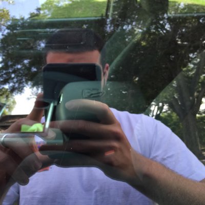

I got home from Home Depot and I noticed a 3 inch scratch on my front driver side window. I can feel it with my nail, although it isn't crazy deep. I imagine it happened when I rolled the window down this morning on my way to or from fishing. Maybe a piece of sand/dirt or something got stuck between the window and seal?
Is the factory tint part of the glass or an exterior film? What is the best way to go about getting the scratch fixed? I know there are some glass scratch repair kits, but I have no experience with them. Thoughts? I'll try to get a picture if I can. It is going to bug the hell out of me.
EDIT: Added photo. Sorry for the **** picture, I couldn't avoid the glare.

Here's a little trick for ya,
Going to sound a little strange but it works. If it isn't a gouge Nada Pumice Paste will work. Or tooth paste that contains pumice. As far as factory tint it's in the glass.
