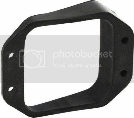

Gonna try using these bad boys from Rigid on the two outter holes and then just flush on the two inner holes. All 4 pods are floods. My plan it to hook up the two outter ones to my fog switch and the two inner ones to my 20" bar switch. My hope is to be able to still run two pods for fogs and then when I'm on some dark backroads fire them all up. With the angle of the bumper the two flush mounts will really light up the ditches on back roads while the two with the rigid mounts with be pointed more toward the trucks centerline.

Looks they they will work nice :)

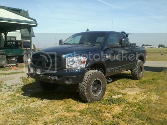

one thing I did on my old 2500 was made a plate and welded on receiver mounts where I could put in a clevis hitch or tow ball or hook.... came in handy on the farm. but I don't know how the tow hook mounts are on your truck, Mine was on a 07 2500. I'd have to find the pics of the fab work but this was the end product, no winch bumper though, just a PattonFab light bar.

I don't want to weld on clevis mounts because I'm worried about bending the bumper. My tow hooks actually attach back to the frame and bumper brackets. With this bumper just mounting up to the brackets and no real attachment back to the frame I'd be worried about clevis mounts.

If the clevis mount is right where the frame or a mount at the tow hook you should be ok depending on thinkness of the bumper. You can always put a backing plate on, but i understand not wanting to put some on.
I wish i knew the set up better to give better suggestions or advice.
