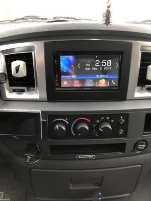

:welcome: Switching to 17" wheels and tires might help with the height problem. Have it checked for a leveling kit on the front as that will lift the front of the truck. if so removing the leveling kit will slightly lower the front end. You can replace the entertainment system with an aftermarket unit. I have a Kenwood Nav. unit in my 2007 truck. Wish you well with your truck.
