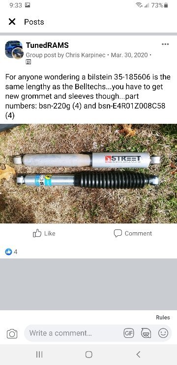

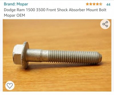

Ok so for those that ever run into this problem like I did.
If you use those spacers shown you simply need these Poly bushings for them to fit. I had to cut the spacers down a touch to fit both the frame side and axle side. Maybe spacer is the wrong word. Someone help me out.
Bolts
And my special Thuren nuts
My problem is I let to shops work on my truck before I decided enough was enough so a lot of what I'm figuring out is their FK'ups without any oem frame of reference.
Still learning as I go. Nice thing I can have that shock rebuilt and have a spare.
