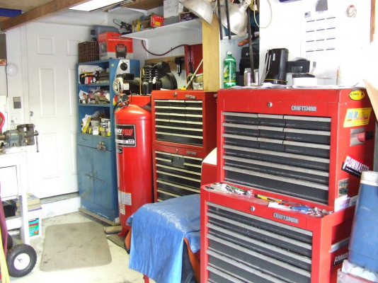

Yeah man. I know what you mean by saving as much real estate as possible. I have a 60x60 shop and even with that much room I still needed a spot to put both of my air compressors. Once I installed all of my lifts, tools and equipment I still needed more room. The shop I have already had a dyno installed and the only place I had left to put the compressors was next to the dyno and I didn't want that. My wife told me to put them outside and run the line through the wall. I have a 120 gallon horizontal compressor and an 80 gallon vertical and they both take up alot of room. I went and bought a concrete pad for each one to sit on and then built a little house for them out of scrap lumber and then painted it the same color as the shop.
