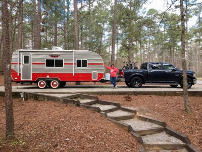

We pull a Retro (Riverside RV) 3,750 (Dry weight) 23'8" trailer with our 2017 Laramie 4x4 with 3.92 gears. Truck pulls it with ease and I like the security of a double axle trailer. Your truck will do the job-just keep the trailer weight sensible. Ours new was $17k.
I've bought used and have no problem with that if it was well maintained and parked in a shelter of some kind. Trailers depreciate like crazy so if you can find a nice 24-26' unit you should be good to go.
