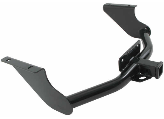

are my eyes deceiving me ?
did you write that you have a CLASS 3 Hitch Receiver ?
that is a shame, if that is all you have

Nah... it's comfortably more than the truck limit, which will suffice nicely.

there are 2 types of Class 3 Hitch Receivers
Frame mounted & Sub Frame mounted
Sub Frame mounted only Class 3
Frame Mounted Class 3
This one is bolted to the trucks main frame rails & the sub frame too
Class 4 is also Frame mounted, just heavier duty
