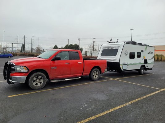

PS: The result (stopped at Walmart on the way home, waited for the wife to grab some stuff...)

Looks like your rig is brush ready :)
Not that it means anything to most people,
the State Of California has made a statement, that the OEM Brake Controller & the Tekonsha P3 are equally acceptable
Looks good nice and level. :party36:
As far as not driving into LA I can't argue with there. I made the mistake of towing out Airstream TT to San Diego years ago and it was a nightmare.
